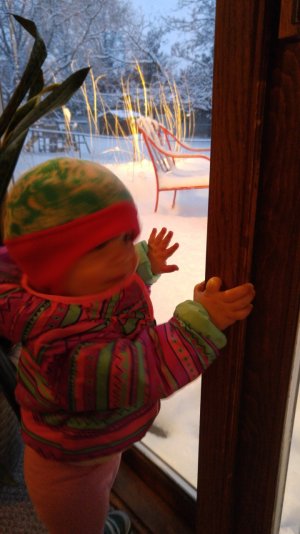

Here's my problem: the G4's camera lag makes it nearly impossible to take quick, candid pictures of my active 1-y/o in less-than-perfect lighting conditions. Outdoors in natural light it's ok (still not great), but indoors in our dimly lit ranch house, next to impossible. Yesterday she was standing at our patio door looking out at the first snowfall she's ever seen, so I whip out my G4 and try to capture the moment. Five second delay later, the attachment below is what I get. Blurry, grainy, crappy picture. And this happens EVERY DAY! It's gotten so bad I just reach for my wife's iPhone 6 (zero delay) if it's nearby.
What am I doing wrong? Is there a setting I'm missing? I'm using the Google camera app (as a workaround to this phone's OTHER annoying photo quirk, the stock camera's weird rotation issue) set to autoflash, no custom settings. Really, really hoping there's a fix for this to get me through until I can upgrade to something less aggravating.
The door frame and left hand are in focus so the camera picked the right subject. (Did you assist it in picking the subject to focus on?)
The face blur is from motion and a slow shutter speed.
To increase the shutter speed to freeze the motion, you need to either add light (flash or house lights) or increase the ISO (sensitivity of the sensor).
In this case, the bright background of the snow is not helping in that the camera is trying to balance the dark subject with the bright background. No camera by any maker usually gets this right, but the DSLRs usually come closer as long as they are not in "auto" mode.
If you manually pick a focus point by tapping on the screen, that point also gets some priority in the exposure settings. If you clicked on the jacket or hat, the child would be a little better in focus and somewhat brighter. That just leaves us guessing how that camera chooses to lighten the scene (longer shutter time for more motion blur or higher ISO).
