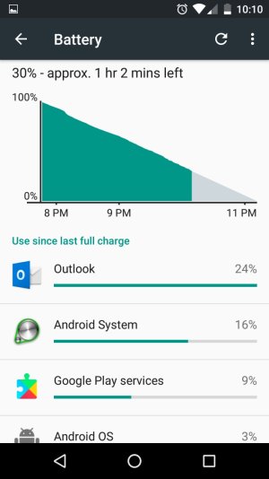

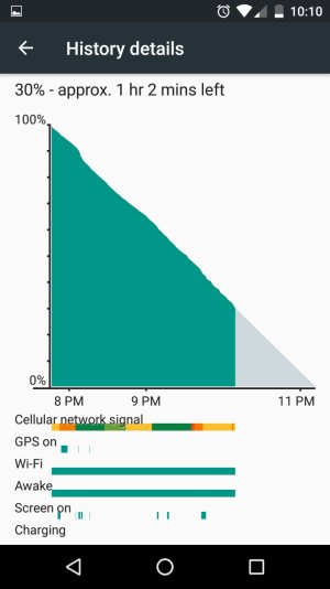

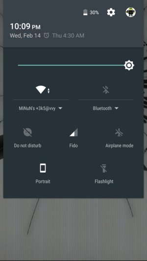

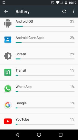

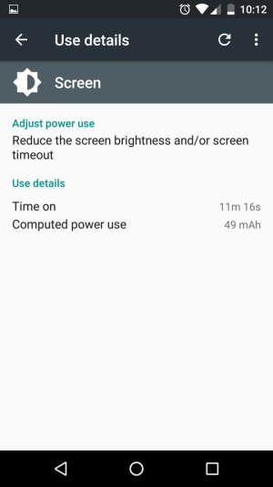

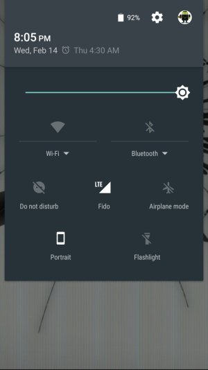

Hey there, thanks for replying, I am the person that posted.
Here are the screenshots as requested, I hope you can find something.

Outlook looks like it's using too much battery, and might be what's keeping the phone awake constantly. Did you change a sync setting there?
As a test, try uninstalling Outlook temporarily and see if the battery life improves dramatically.
