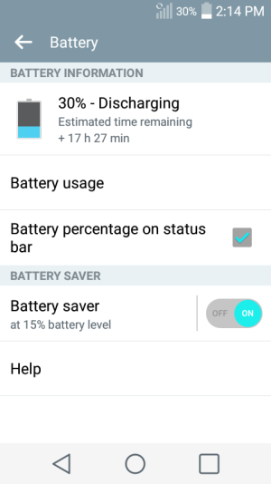

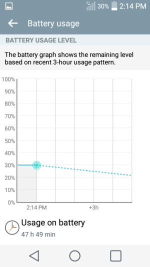

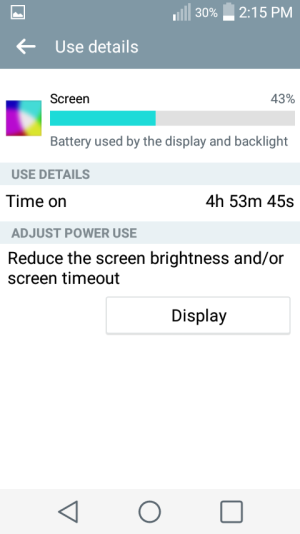

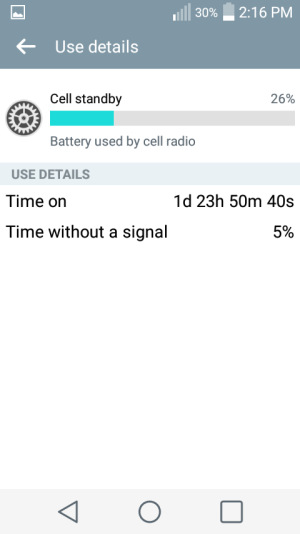

OK - not sure if these are the right screenshots - but my phone is at 30%:
Not sure this will work - LOL!
Thanks for any thought or if this seems normal!
TN
They're not quite what I was looking for--it's ideal to see the whole battery graph from 100% down to 20-30%, so we can see what the cell signal strength has been like and what the awake time has been. But I can tell from the high Cell Standby battery usage (and the fact that 5% of the time you didn't even have any viable signal) that your cell signal strength is often poor. This can contribute to battery drain, since the phone is struggling to maintain a signal.

Though - no signal for 5% of the time over the course of nearly 2 days isn't as bad as it seems to me that it is - LOL!
Remember that it's not just zero signal that causes battery drain--it's poor signal. If you have lousy signal but still some sort of connection, it won't be reported as Time Without Signal. You could have 0% Time Without Signal and still have massive battery drain if the phone always has 0-1 bars.
Not all phones have the fullscreen battery graph showing cell signal strength. Go to Settings>Battery​ and tap the graph--does it show you the fullscreen graph? If not, you could install a 3rd party battery monitor app like GSam Battery Monitor.
So - if I am in a low signal area and not using the phone, is it better to just turn it off to save the battery? What is considered an adequate signal - 3 bars?
My battery graph doesn't display the full screen. Tapping on it doesn't do anything - but I can scroll it back and forth to see more.
