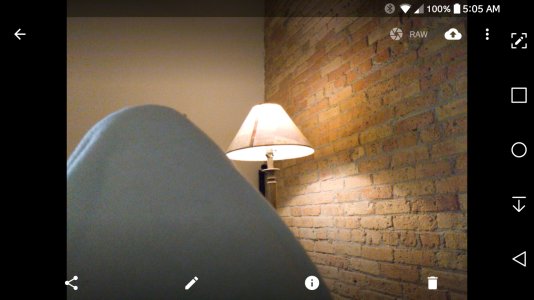

Update:
I'm not sure if the V20 was able to do this before, but I'm now able to view RAW (DNG) pictures from the Photos app. This is great, so now I can preview what the sensor is really putting out without going to the computer. However, the file is still saving at 1MP. Definitely a flatter, brighter image. This camera's Dynamic Range really needs to be fixed. We went from a darker-biased image on the V10 to blown out highs on the V20. And the Noise Reduction is terrible (in Auto and slightly in Manual). Not quite deal breakers though (even at Best Buy/Sprint pricing).

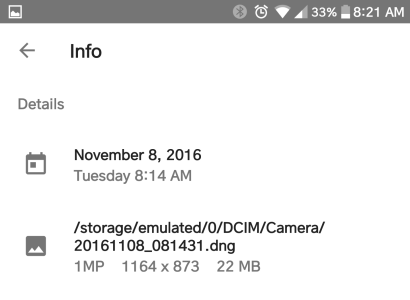

Now that I know how to add photos to the Forum, I can submit an example of what the RAW photo properties state.
This may help:
