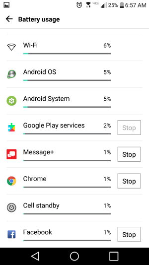

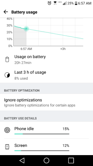

I installed the Gsam battery app and it did not drill down specific enough, it said "App Usage", 30% of the battery sage. The rest was screen time.
GSAM requires you to use ADB to give it access to enhanced data for it to be accurate. You only have to do it once, but to truly use it to track down abusive apps you do need to take that step.
