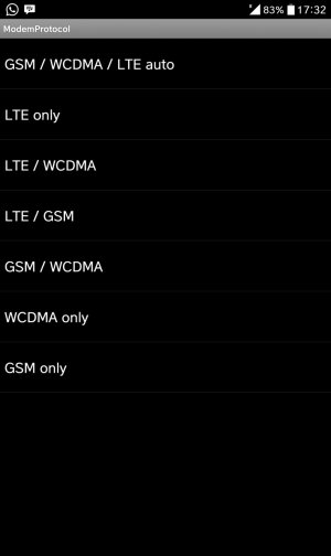

Anyone has try dial *#546368#*990# on usuall call mode? This is hiden menu. I dont know if it is work on another country,but it works well in Indonesia. After you call it,the black screen will show up,choose the most bottom,Field Test-> Modem Settings-> RAT Selection. And then you can choose which network you prefer to. Here it is the last screen after we choose Rat Selection;

I don't know in another country, but if V20 run in 4G LTE (4G icon on the left side next to signal), it drains battery significantly here in Indonesia. That's why I often switch to GSM in some conditions although 4G is more reliable and faster ??????
