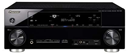

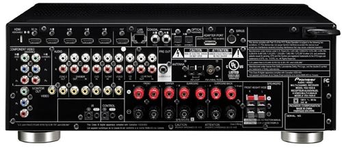

Maybe to clarify, I should put it like this: I'm looking for a mini version of one of these:
Instead of having a whole mess of inputs, it just needs one. And it doesn't need to have an amplifier built in like standard A/V receivers do. That'd be fine, but I already have a fairly small, weak (which is fine for my purpose) amplifier to sit between the decoder outputs and speaker inputs.
