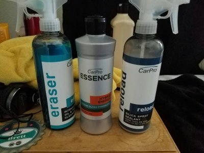

I came across a product that was supposed to be a liquid screen protector made of quartz. The first thing that popped into my mind: CarPro Cquartz. Since I wouldn't want to use something that permanent and finicky on my phone, I decided to bust out some other CarPro products I had lying around the shop.
Eraser is essentially scented alcohol with other proprietary blends. 3-5 wipedowns with alcohol will give the same result. I used eraser because it was readily available.
Essence increases durability but is not the top layer, so results are equivalent with or without it; eraser hopefully will prolong applications.
Reload is 5% silicon dioxide. It is anti-static and weather-resistant. In this usage, it is nearly fingerprint-proof. Spray directly on the screen, wipe, and buff any remaining streaks.
Reload is expensive for a mobile device coating. However, you can also get incredible results on your car with this same product and I barely make a dent in the quantity of product when I use it.

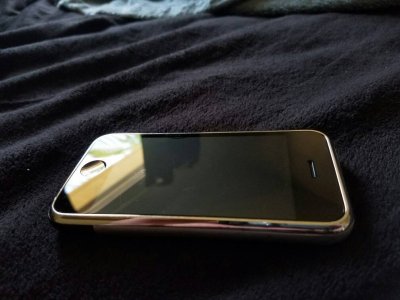

I did the while process on my iPhone (original, 2007 device) which never came with an oleophobic coating. Here is how it looks after wiping my entire palm followed by my fingers on the display:
