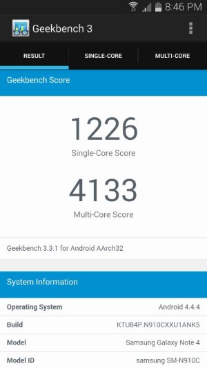

Did the partition wipe and got a much better result and the phone is much better. Attached the screenshot of it. Why did this need to happen?

I'm not sure of the specifics. But I first learned of this trick using the note 3. Starting have horrible battery life and lag. This fixed it and has fixed virtually any issues ever since. Glad it helped! Props to the poster who recommended it!

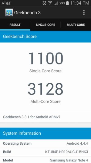

Is yours the snapdragon or the exynos because I just tried the app to see what mine would get and I got higher score. Mines the exynos version. Higher is good right?

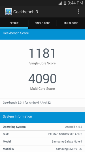

Huh, I used to do it on my previous device everytime there was a software update and it's always improved performance. But after clearing the cache I actually got slightly lower scores (tested 3x before and after).
Dropped about 50-70 points average
