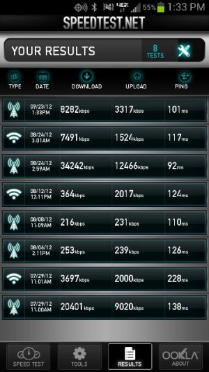

And to get slightly back on topic, here's my just now observed speed test compared to some historical ones. The tests immediately before the most recent were early in the morning and the wifi one was via a wimax hub, then the next several were via EVDO or 1x in the middle of the Nevada desert, the test before that on the 29th was approximately representative of what I saw until Saturday - around 20 mbps but sometimes as low as 12 or 13.

And another, and this is about as low performance from lte as I have yet seen. Also the fact that reverse channel is faster than forward channel is one of the more traditional indicators that there is spectrum constraint.
Tower / sector ID is 04872 for the record.
