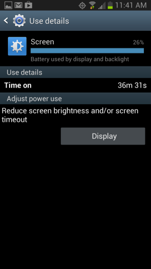

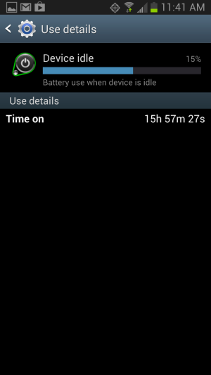

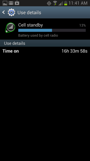

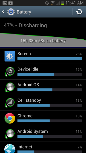

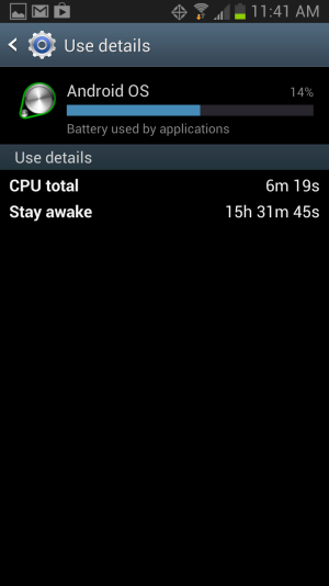

I'm fairly new user of Galaxy SIII (updated from iphone) and to be frank I don't use the device much except for calls, texts, occasional web browsing, and that's it. The phone would last at least 2 days, usually 3 days because of minimal use. I'm also not too familiar with Android, except basic stuff.
Anyways, I made a mistake of updating to the new Verizon OTA update and now with same minimal use the phone drains like crazy. For example, I charged it full last night, and then when I woke up today, the phone's drained almost half, during which it was asleep, no usage at all.
Also, in the battery section, it says the screen's been on for only 36 min, but it seems as though Android OS and Cell Standby are awake the entire time screen is idle (15 hours 31 min) and maybe that's why the battery is draining even though the screen is off?
Does anyone have similar problem, and any possible solutions?
I also attached screenshots of battery section, just in case.
Thank you.

16+ hours and at 47% remaining is really great battery life.

Based on your Screen Shot it was on battery 16h 33m 58s and at 47%. All I am saying that is good battery life for that length of time.
I agree 16 hours off charge and sitting at 40 something percent is good compared to me and some other users I have read about. My phone drops 8% within in an hour literally just sitting there doing nothing. Does anyone know what the largest MaH battery size is that will fit in our phones without replacing the battery door? I am using an Otterbox case and still want to be able to use it. I see a lot of batteries on amazon but none of them seem to say anything about replacing the battery door unless it comes with the battery. Thank you for any info.
