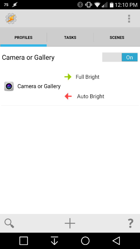

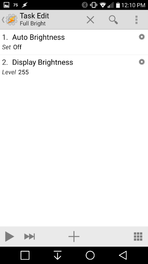

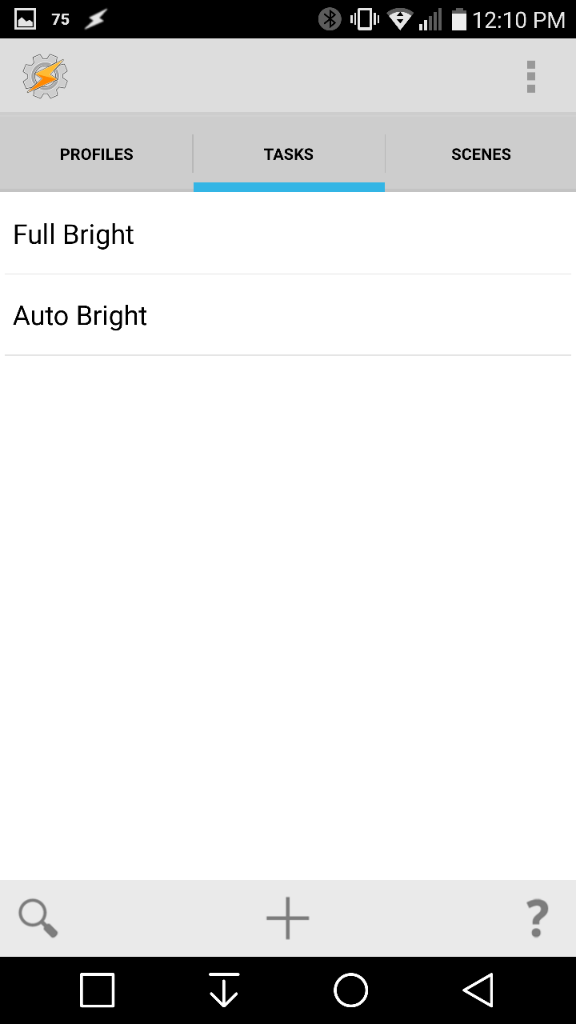

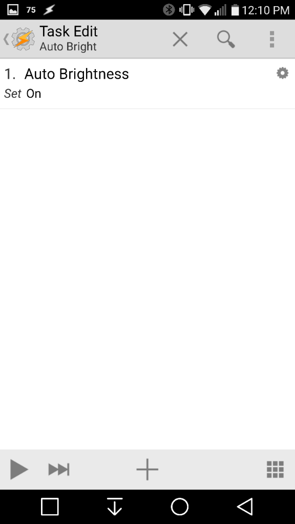

Here are some screenshots from Tasker, using just the built-in brightness (ie no need for Lux) - do full brightness for both camera and gallery. There are lots of help posts out there for Tasker, so I won't go into that here.
//uploads.tapatalk-cdn.com/20161226/d9d74f11d76c8e2884fa4b85f09b29c4.jpg//uploads.tapatalk-cdn.com/20161226/256778b2d76e0e2bf92574f0af8d097e.jpg//uploads.tapatalk-cdn.com/20161226/d0a49cbeca579754bca94f468ea733b0.jpg//uploads.tapatalk-cdn.com/20161226/87456c1cfb651a3ce5b6b12a4d0d4e8a.jpg
Thank you! I was able to do what I wanted using the task "plugin" then lux and car mode when using certain apps and day mode when exiting those apps
Awesome, exactly what I needed. Thank you
