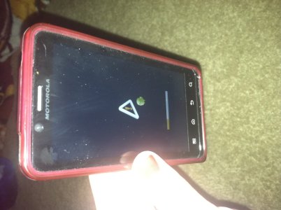

Yes it was rooted but I unrooted it and went back to Stock. Did a factory reboot and tried to reinstall it and didn't work. Sigh. I really wanna go back to my bionic.

Seriously, give House of Bionic a look. SamuriHL has been making life easier for Bionic owners since the first ICS leaks started to come out, and the process is now pretty well refined.
Indeed. I've yet to hear of anyone that couldn't get ICS to install vita House of Bionic. Even users having troubles got it to work that way.
I suffered the same issues with my Bionic. I actually used House of Bionic to FXZ to the stock Gingerbread. I was then able to upgrade via the OTA - but all-in-all, it may be easiest to just use HoB to move to ICS.
