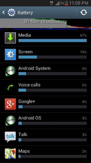

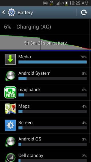

Media server killing my battery
ammaralo
Dec 29, 2010
48
See attached pic. I tried everything, the only solution is completely UN mounting my sd card.
This is ridiculous
Help!

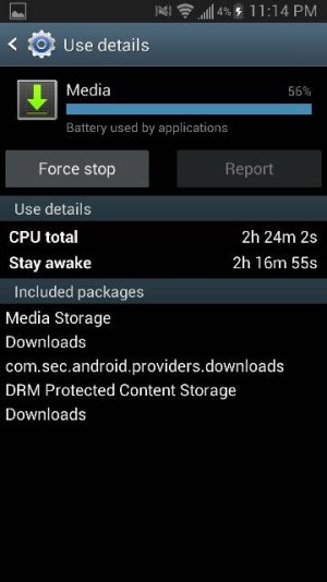

What is drm content and do I need root to freeze it?
Sent from my SPH-L710 using Android Central Forums

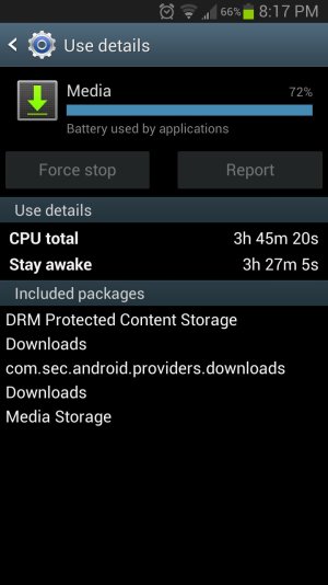

Yes you need root to freeze it. It gs3's already been a battery drain.
en.m.wikipedia.org/wiki/OMA_DRM
It it's an app that determines if any off the media is DRM protected. It will constantly run in the background looking for drm content. DRM= digital rights management and its basically looking for copyrighted media that it's protected by DRM.
What would happen if I uninstalled it? I need pay version to freeze it.
I wouldn't uninstall it. You may have music or movies that will require it to play. In that case you can just defrost it. It can't be reinstalled if you remove it.

This is due to sd card you have inside the phone. Remove the SD card, fully charge your battery and monitor.
I was told to use rescan media root to disable media scan so media wouldn't affect my battery. Idk though. Only if youre rooted
Was there ever a fix for this? Root is not an option for me. I also do not consider removing the SD card a fix...although it does work. However, I lose a lot of storage that I would like to have back. I am 100% certain that this is caused by the SD card, since I put it back in an hour ago and watched my battery drain about 20% in that time. I removed it and all order has been restored. I have reformatted the card multiple times and there is currently nothing on it, so I am not sure why it needs to be scanned.
