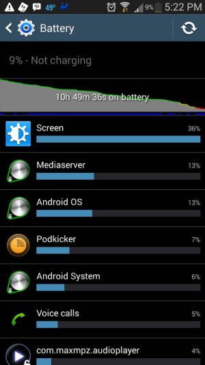

You mean something like these? I'm experiencing this issue as well, and I can pinpoint to the exact moment it started: right after I updated to 4.3
A couple of questions:
Did this happen after a reboot, or is it continuing consistently? It's normal (unfortunately) for the device to rescan your storage looking for new media files after a reboot. So if you have a lot of media files, it can use up a fair bit of battery after a reboot. Even given that, this seems pretty high.
I think the next most common issue that causes this is a corrupted nedia file or a corrupt directory on the SD card. If you have an SD card, unmount it, remove it, and reboot. If the problem goes away, then you have a bad file or directory. Copy eveything off the card to a computer, then reformat the card in the phone. If the problem comes back (unlikely) you've got a bad card. Assuming it's OK, then you might have bad file(s). You can do two things: copy everything back, and hope the reformat cured it, or you can copy them back a bit at a time, wait a day, and if the problem returns you know the bad file was in the most recent batch.
If removing the card didn't resolve it, then you probably have a bad file on internal storage. Copy all your media files to a computer, and delete them from the phone. Reboot, and see if that resolves it. If so, copy them back a bit at a time, as above.

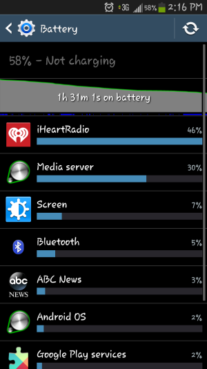

I started with a full charge, and after only using iHeart radio, the battery is at 58% and has been in use for 1.5 hours. I have a screenshot of the battery usage, but I don't know how to post it using the Android central app.

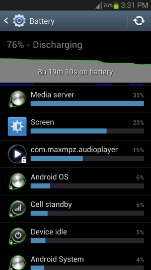

You want to know something funny, I just looked at my battery stats and sure enough media server was the highest for me at 35%!! I always thought it was because I have a big SD card (64g) with A LOT of music (40g+) and I'm constantly using PowerAmp. No, my battery drains nice and slow....although lately, its been draining quicker in the morning since the battery is now going to be 2 years old soon. Perhaps its time to reformat my SDcard and do a full factory wipe....its been awhile since I shook things up, lol!
Here's my screenshot with battery usage. I would estimate that I didn't get more than 3 hours of total use before the battery reached 12%. I really don't know what drained it so quick.
Any time you're playing music, media server is involved, I think, so it's not surprising that's your highest battery usage. Are you listening via wifi, 3g, or 4g? Playing online music is pulling a lot of data, and that will use a lot of power, especially if the signal isn't very strong.
Does the screen stay on while you're listening? That uses a lot of power, too.
I can't help you wit the AC app. I don't use it.
I posted a screenshot of my battery usage.
The majority of the time I am using iHeart radio, I have a 3G signal but it isn't always very strong. The screen is off when I am using iHeart Radio. I actually did a bit of an experiment and found that Pandora isn't using much battery power at all, but when I am using iHeart radio, it pretty much drains the battery down in a short period of time.
