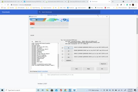

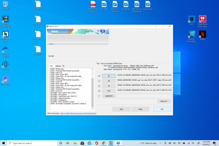

One step closer with a new cable, using odin 3.14.4 still has the sha256 error. Using the older version with the 3b patch now says "setting up connection" and never changes.
Wait it out for settings up connection
