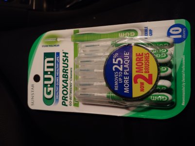

What I did to fix mine was
1. Turned phone off
2. Used a G.U.M. PROXABRUSH. (Tight)
They are like $3.59 a pack at walmart.
3. Dip the tip in rubbing alcohol and use it to clean the port.
4. Blow into the port until dry.
5. Leave the phone powered off and plug the charger back into the phone.
6. Once the phone is plugged in a lightening bolt will show on the middle of the screen. Double tap it and your phone will begin charging again!
You're welcome.
