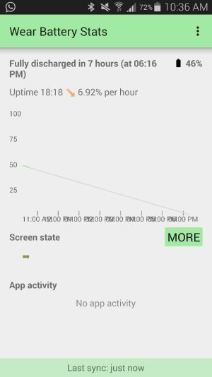

Update: I have deleted most of the apps I had, deleted motorola connect, disabled Google fit, deleted android wear and downloaded again, reset the watch with about 50% left.
And now it's saying around 7 hours of life on it with 46%.
I really encourage you all to do these steps since it seemed to have worked for me.
