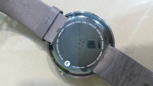

I noticed this crack the other day when I was putting on my watch. I have never attempted to replace my band and it has never been in any situation where it was struck or dropped. I contacted Motorola and it is being covered by warranty. I think the cause is how the opening of the watch where the band attaches and comes in contact with that inside curve. I think they should have just gone straight across.
I have heard a lot of people that say that the back of their 360 has been cracked. Definitely seems like a design flaw.

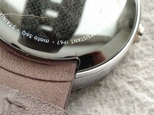

Hey, I started seeing this problem as well and decided to get a sharp blade and heated it quite a while so I can make these cuts on the back since it's made of plastic, this was possible.
As for why the cracks appear the only reasonable explanation I have is because when you wear the watch, the band presses against the circular part and so it causes tension on that specific part of the watch.
I suggest you do this with a little more care since as you can see from mine, I messed up a little on the corner and it ended up with some scratches.
