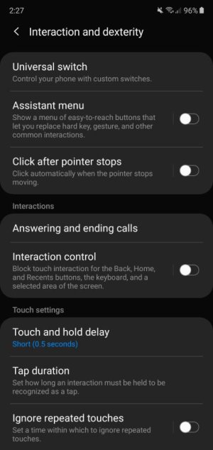

Visit site
Not sure I understand that instruction. Where to find and how to do?
Go into phone settings , then scroll down to accessibility and tap , activate menu and return to the home screen should be a floating icon which you should be able to.open and access power off , recent apps ect..
No case, and buttons move freely. good tip though.
Your welcome ..sometimes it happens
mustang7757
Super Moderator
Moderator
Feb 6, 2017
94,624
9,736
113
Visit site
This is the screenshot of accessibility menu , can type assistant menu in the phone settings search bar to get there fasterScreenshot_20190909-022739_Accessibility.jpeg
