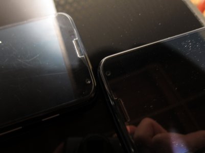

Yesterday while looking at the front of my phone I noticed the front camera appears to be obscured by some kind of plastic spacer.
I haven't dropped my phone or given it any high shock hits. It has been very cold here this past week though and I did have it in my coat pocket while we were outside for an extended time.
Has anyone else seen this happening?
http://i.imgur.com/ws8Psdj.jpg
Also, although it doesn't actually obscure the camera there is a noticeable "haze" on the images I take using the front camera.
Edit: I got my phone in October I believe - Is this something which might be covered under a warranty?

Same thing happened to me. I noticed the film/glue/grommet starting to cover my front facing camera after I came inside from snow blowing my driveway. It was very cold (negative single digits) and my phone was in my outside pocket. I spoke with Motorola and it should be covered under the one year warranty. My plan is to have Motorola repair the issue before it becomes a real problem (i.e. obscures the camera).

I have had no fewer than 4 Moto X's with the same issue. Over time, the little spacer around the front-facing camera just creeps lower and lower until you get all sorts of lines, poor lighting, etc on the image (which wasn't all that great to begin with). I keep calling them to complain about it and they replace (not repair!) it under warranty. My 5th one is on the way, and they agreed that if this one develops the same issue that I will get a refund. My admittedly unscientific hypothesis is that it has to do with heat and humidity. I carry mine in my back pocket almost all the time which may loosen whatever glue is designed to keep this little spacer in place.
While Motorola has been great about replacing this under warranty -- and I'll note they let me keep the old one until the new one arrives -- setting up a new phone is still a pain, and I'm averaging a replacement every 3 weeks. In any case, yes, call Moto, it's covered.

On a normal phone with no issues, you won't see the piece I'm referring to. Attached a photo of the issue. The phone on the right is a brand new replacement, the one on the left has the issue. Note the brand new replacement gradually developed the same problem.

Was yours a customized Moto X? From my understanding (based on spending hours on the phone with Moto Care), the repair process is only for non-customized devices purchased through a carrier or devices out of warranty. I bought mine outright from Moto w/custom colors. And I actually pushed for them to repair mine...my reason being that if it really is a manufacturing issue, a replacement will (and has) just develop the same problem. But they said this is not possible...I *have* to have it replaced. Moto X #5 arrived today, so we shall see if the same thing happens.
