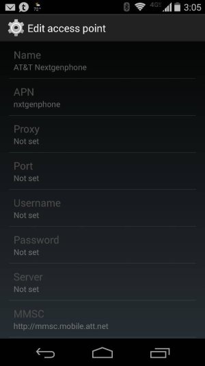

1, Go to phone settings —> more… —>mobile networks —>Access Point Names and delete all the existing APNs.
2. Create a new APN using the + icon or related options … then, enter the settings below
APN: phone
Proxy: Not set
Port: Not set
Username: Not set
Password: Not set
Server: Not set
MMSC: http://mmsc.mobile.att.net
MMS Proxy: proxy.mobile.att.net
MMS port: 80
MCC: 310
MNC: 410
Authentication type: None
APN type: default,mms,supl
APN protocol: IPv4
APN roaming protocol: IPv4
Bearer: Unspecified
Mobile Virtual network operator: Not set
3. Restart phone —
4. Check Internet and MMS Capabilities
In case anyone finds this useful.

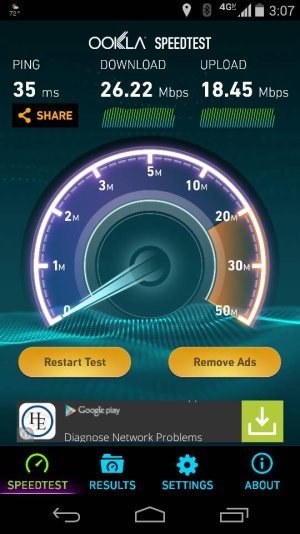

I can say that I had this problem as well. Voice but no data. Added the custom APN, and that got me 4G, but no LTE. Apparently, ATT does not recognize this phone's IMEI as a LTE capable phone. Had to give them the IMEI off my HTC One M7, code it as LTE, reboot my phone twice, and then it came up as 4GLTE. Just FYI.

I finally got them to change my IMEI to a phone that is LTE, ( I used my old N5 too) but any att phone that is LTE
I went to store & guy there confirmed Motorola Victoria shows as a 4G only device
It will show 4G LTE next to battery
Yes. Just chatted with someone online and told him to try to change the IMEI just to "see" what would happen.
Put an S3 IMEI and boom, worked. Thanks for the help!

It took some serious arm twisting, but I finally got the online support person to change the IMEI on my Moto X (used the one from my Nexus 5). She and whoever she talked to in tech support advised against it, but I asked her to change it anyway. Now I am on LTE. I switched back to the original APN also (nxtgenphone one), and that worked also.....
thanks for the posts. Did an online chat with AT&T and had them put my nexus 5 IMEI on the line, had no issues they did it right away on the chat (maybe their getting this added to their help desk manual). Put default Moto X APN setting back and worked like a champ... got 4G LTE indicator.
