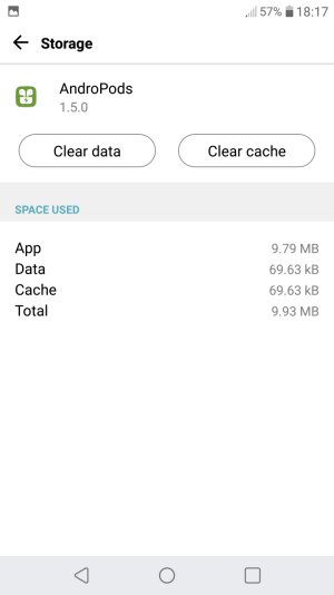

Tested on non-rooted LG G5 H850 with stock Android Oreo 8.0. What info have I gathered:
To move app from internal storage to external SD card storage go through this steps: Settings -> Apps and notifications -> App info -> select app -> Storage -> Storage used change -> select SD card.
But not all the apps have a feature to move itself to SD card. You can easily check availability of such feature using "Apk Analyzer app by Martin Styk" - just look at "Install location" field (tap on field for explanation).
Here you are two pairs of screenshots, where shown:
1. how does look app info, if the app have "move to sd card" feature
app info with change storage feature.jpg apk analyzer info of app with change storage feature.jpg
2. and how does it look, if the app doesn't have such a feature
app info without change storage feature.jpg apk analyzer info of app without change storage feature.jpg
