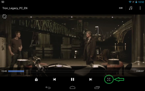

Welcome to Android Central! Using MX Player, tap the screen when the video is playing, and then tap the icon to the right of the skip forward button. That should toggle between the various display modes (Stretch, Crop, 100%, Fit to Screen).

I tried all the display modes and also the ones in VLC and nothing got rid of the borders. I need to check the source content as this doesn't make sense at all! I am fairly sure the native video player should full size the picture as long as it is 1280*800 and MX Player and VLC should also be able to handle it with their display modes, so fingers are now pointing at the videos themselves. I will convert a few more tomorrow and test.
