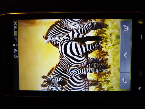

UPDATES! Well...nothing "new" really if you've been reading up over @ XDA or the T-Mo forums about this issue -- but I'll post photos of the differences in the screens. I was fortunate enough to get my replacement less than 2 days after I requested it - guess UPS ground has a pretty direct route from TX to the Chicago area. Besides that, I was even more fortunate to get the "superior" display. I was at first concerned because it was made in Taiwan where people have had a lower success rate of receiving a good display....but then I noticed the FFC was dead center, and that gave me hope even though there is no proven correlation between the slightly off center FFCs and centered ones.
Noticed in the construction, nothing major....but just what I observed, and I'll post those too with photos. I only wished they shipped replacements with new battery covers because mine is scratched up from the "4.5 ft drop onto concrete" thread, but it's not bad...and I'm sure I'll be able to get a replacement battery cover eventually.
Anyways - I'll edit this post a little later tonight with some photos!
Replying instead so that people know pics are now loaded. All "good" screen photos will be on top, "bad" screen photos immediately below. Brightness set to auto - did the best I could to keep the same angles for the most part. Lighting in the room was darker so some of these photos aren't the best -- but the difference in the screens is obvious. They ship replacements without batteries/batt covers if you were wondering why I didn't just power them up next to one another.

These photos show how different the screens really are viewing straight on..

Notice I didn't use extreme angle viewing on these pics...but as you angle even more, the "better" screen will not wash out where as the "worse" screen gets exponentially worse until it's nearly entirely washed out.

These show the "settings" bar and black levels. The settings bar should be grey, and have no perrywinkle as described in post #34 of the XDA thread I posted above. The screen was actually so bad at this angle that after many attempts at this photo, I gave up on the bad screen. Blacks are especially reflective and annoying, and I wanted to preserve the same lighting so I didn't try to get a better photo. I also did not shake the camera...the reflectivity washes/blurs the image.

Notice the "good" screen on top also has a perfectly centered FFC. The "bad" screen has an FFC slightly to the left. There is no correlation between centered FFCs and good screens based on XDA and T-Mobile forum observations.

Hope some of you find this informative if you didn't travel to XDA and hunt around there for photos. When I turned on the "good" screen, it was not entirely obvious that it was better at first glance. Obviously I could tell immediately from an angle, but to the casual viewer - unless they're side by side, you may not feel like you're missing out on a better screen besides the viewing angles. If you're rooted, custom ROM, many paid apps you don't feel like emailing devs on to replace, etc.... it may not be worth the hassle. Though you definitely should call for a replacement and get what you paid for -- unless you're a freak about graphics like me and can't stand using DVDs in your BluRay player even though it upscales, blew $1800 on a Panasonic V10 plasma, and hate anything less than HD and calibrated colors...I don't believe the inferior screen takes away from the experience too much.
EDIT: Forgot to post this one...there is one advantage to the bad screen - viewing angles in desk mode with display DIM...if anyone actually uses that ("superior" screen on top, bad screen on bottom):
