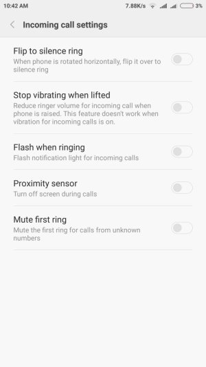

However, the problem still persists. See the screenshot, all my incoming call settings are turned off. Still the recording/music pauses while being played on Whatsapp.

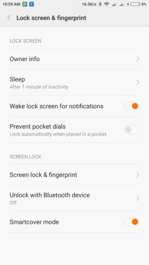

I found "Prevent Pocket Dials" setting in the Lock screen and fingerprint tab, but it was turned off as default. Still the recording/music pauses while being played on Whatsapp.
