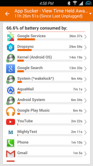

The thing I often take for granted is just how much better things are with root privileges; GSam with root blows away GSam without it and it's not the developer's fault, stock android simply does not provide access rights to enough information to make well informed analysis of battery usage. As a result of the limitations to data without root, battery monitoring applications will not report things like wakelocks and wake times which is critical to finding rogue apps that are consuming battery during standby. I know its frustrating to hear users such as myself heralding apps like GSam or the ability to reduce battery consumption but do understand that these claims aren't unfounded, its just that sometimes we take what we have for granted.
Here's an example of a screen in GSam available to root users which shows the amount of time an application kept the device awake over the entire period of monitoring. It can be seen in this screenshot that over the 11.5 hours of monitoring Google Services held the device awake a total of 36 minutes. This kind of information is extremely helpful since it can be used to determine heavy users of processing power by simply resetting statistics (a clean boot) and leaving the screen off for a long monitoring duration (at least an hour) before checking stats again. After an hour or so if any applications other than Google's are showing a high amount of wake time then this could be considered a potential red flag.
Other screens are available as well which will show things like the number of times the device was awoken by each application etc.
Granted, some services like Google Services will encompass so many subprocesses that it will seem nearly impossible to control wakelocks there but at least with information such as shown above a user can quickly narrow things down to a particular application.
