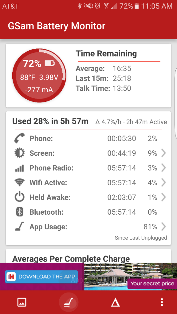

My battery life has become quite suckish lately!

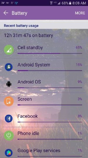

It's your cell standby usage. I just recently had this problem on my S7E, too. (My cell standby battery usage was around 50%.) Following a post on AC about similar problems with the S6, I went into settings and changed the location services to "GPS only" and now my cell standby is down to about 13% and the battery life is back to where it was when I bought the phone. In particular, it's much better when I'm not using it. Location still works well enough for my purposes (using nav while driving), though I have heard that this might adversely affect Google's ability to magically know every place that you've been and serve up relevant suggestions. (I find this feature vaguely creepy and won't miss it.) FYI, my house and my office both have good wifi but so-so cell reception.
Hope this helps!

lol. Well it's not a very smart phone that hammers the battery looking for a signal during the hours while I'm asleep. lol
Hope this helps!
That's weird, and interesting. Under Android location is settings "Battery saving" (use wi-fi, bluetooth, and mobile networks to determine location) is supposed to be the most battery efficient setting. If GPS (which I prefer anyway) is actually more battery efficient then that is very interesting.
