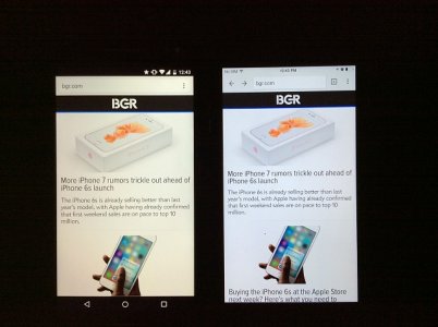

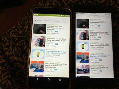

My Moto X Pure Edition also has this yellow tint. In fact, I believe they all do. I've been to different best buy stores, and they all look quite similar. For those claiming their screens are definitely "white," please put your phone side by side with an iPhone 6 Plus at some point and upload a picture. However, the yellow tint on the Moto X Pure Edition is still better than on my Note 4. No matter the settings on the Note 4, the screen is always yellower and darker than on the Moto X Pure Edition.

Moto.jpgI'm going to resurrect this post to add my 2 cents and maybe get advice.
I received my Moto X Pure today. First thing I did was charge it up, screen looked fine, then I updated to Marshmallow, screen looked fine, installed my ATT SIM, screen looked fine, installed an Otterbox Defender case and noticed the screen had changed. It looked like the left phone in the pic above. In the pic above the yellow is more on the left. Mine was the exact same way but more pronounced.
I immediately thought maybe the Otterbox screen shield was discolored, uninstalled it and the yellow was still there. I decided to turn off the phone and restart it, was back to whitey white! And has been fine the rest of the day. Any input would greatly be appreciated. Not sure if I should try it for few days and see what happens or go ahead and try to get a replacement?
My first Moto X Style was yellow out of the box, just like the photo on the left above. I hated it and couldn't live with it. Moto Customer Service in UK was very good and patient. The best solution was to ask for a refund and order a new one straight away. This was far quicker as a replacement could take some time. Also it was explained to me that if I took a replacement and the screen was yellow again, then I couldn't refund a replacement phone.
Second phone is perfect and looks like the one on the right above. Side by side, it was like night and day. I'm so glad I took this route.
