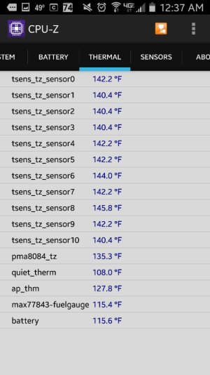

Just to clarify, are you saying CPU temp or battery temp.
My stats above were for battery.
I just installed an app to check my CPU temp and it shows 140+° F (much more than you reported). And my phone does not feel hot at all.
