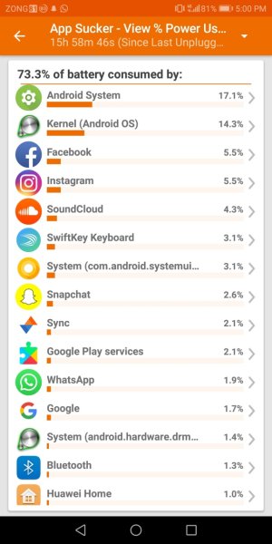

I have downloaded Gsam battery app and it shows that 76% of my battery is being used by Apps.

This Gsam Arena's screenshot. It says 72 percent battery is being used by apps.

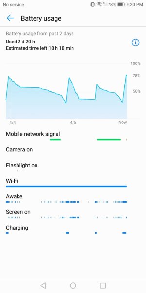

A picture of the battery settings

Check above mentioned reply for screenshots. But to clarify, I live in an area with poor cell reception. This is why I keep my sim turned off for the majority of time.

Yeah that's what I thought too. But I haven't installed any app recently. This is why installed gsam battery monitor and gave it permission from adb to get stats. I have attached a screenshot of it in above replies.
The problem is that sometimes apps might utilize some component of Android OS, which makes it difficult to pinpoint the app that's truly responsible if you look at the battery stats.
Facebook is notorious for hogging battery and memory, so you might want to try uninstalling Facebook temporarily (you can always access it on the browser).
