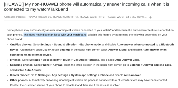

I am a motobike rider and using BT earphones (Haylou) (While riding motorbike)
I have also huawei watch fit2 and synced with my Samsung (android) phone
Also setted as "Auto Answer Calls After 5 scnds" while connected to bluetooth (to haylou)
But When I am not using my earphone (hoylou) my phone calls opens automatically after 5 scnds because its connected to Huawei
(not biking and not using haylou)
I cant find how can i stop this auto answer all calls while my phone not connected to earphone.
The solution DISABLE BT but in this case i cant see calls/msg etc via smart watch.
Any idea?
Regards
Didy
page (that you mentioned) says "go to Settings > Answer and end calls, and disable Auto-Answer."
I said: I set my phone AUTO ANSWER AFTER 5 snd WHILE CONNECTED to BT
If i disable it i cant use my earphone while riding...
did you understand case???
The setting you mentioned is in the Phone app? Can you show a screenshot of that menu and its options?
If I'm understanding correctly, there may not be a good solution . If Auto Answer has to be on in order for the earphone to work, then when you turn off the earphone, the watch will still auto-answer because that's what it's designed to do, according to that Huawei help page.
Ok, thanks for clarifying that. As I mentioned above, it sounds like there may be no way around this, since the requirement for your earphone essentially clashes with how you want the watch to work.
It sure seems like it would be up to the watch, but the fact that Huawei published that help site that states "This does not indicate an issue with your watch" would suggest to me that they've heard these kinds of complaints, and they're basically saying that it's working as intended. Their only solution is really to turn off the Auto-Answer feature on the phone.
You could reach out to Huawei support to at least suggest this as a feature, but I'm not sure how far that will get you.
