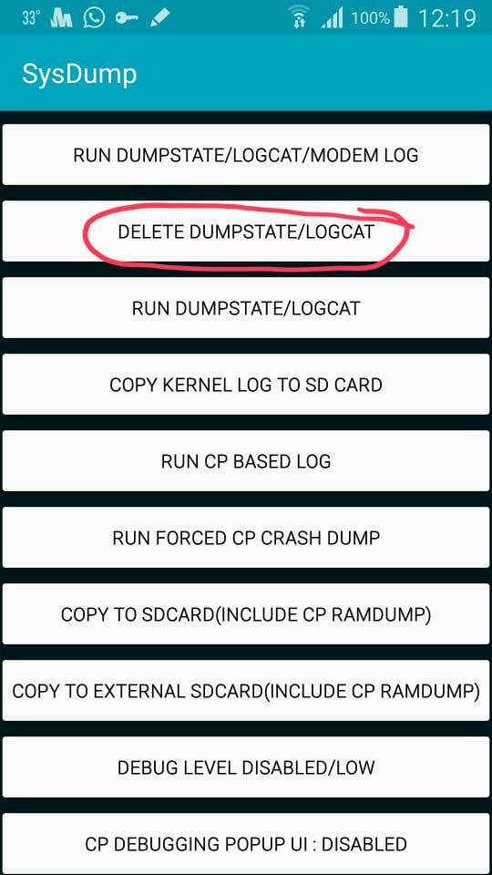

I don't know if a "delete dumpstate" will help in your case. A long time ago I once had a memory discrepancy issue which the "delete dumpstate" tool resolved. You can try of you want (no side effects):
1. Save any work you are doing on the phone.
2. Go to your "phone dialer".
3. Type: *#0*# (Note that on typing the last character...the hash...a menu should appear).

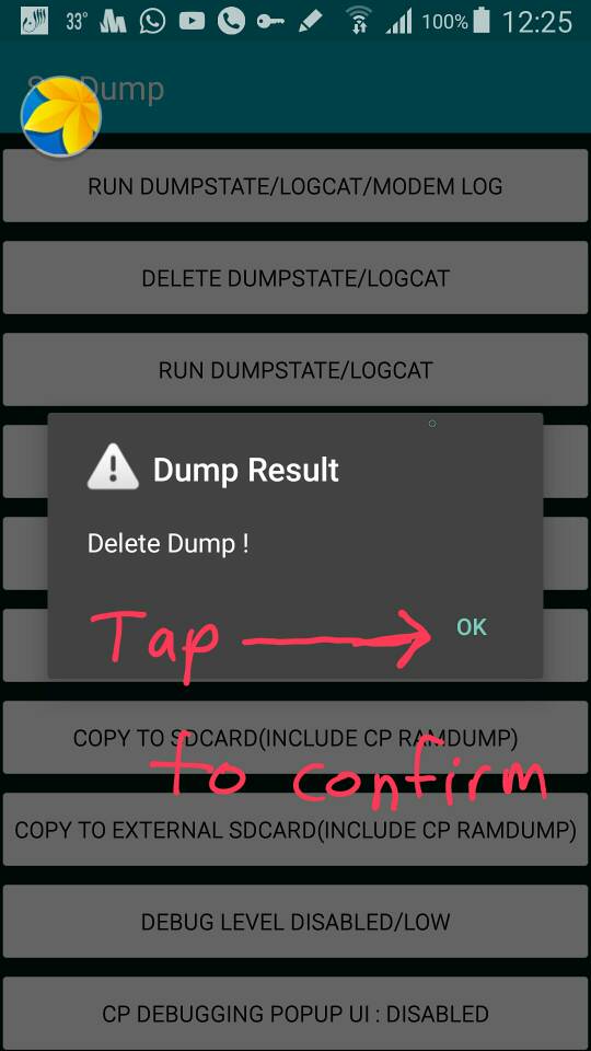

3. Select the item "Dumpstate/Logcat" (see screenshot attached).
4. Tap "Ok" to confirm.
5. Restart your phone immediately.
