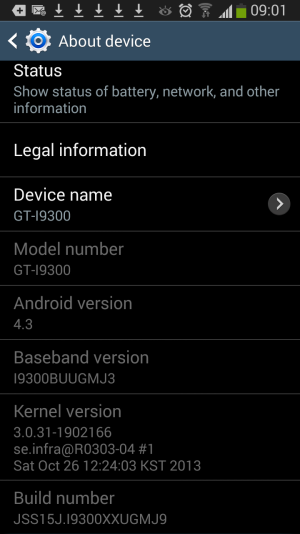

Hi, after yesterday's firmware upgrade (700MB+) my Samsung Galaxy S3 (downloads?) and notifies me about "Download complete" of the same cca 50 files over and over again immediately... After clearing the notifications, the same "Download complete" for cca 50 files appears again and again (no matter what connection I use). Attached is phone's "About" screenshot with many "arrows down" in notification area on top. Please help/advise. Thanks.
