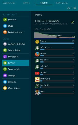

okay. i am so confused with this thing since yesterday.
i used it yesterday to watch online movie when my battery was at 50-60% something. and then it gradually dropped like usual until 15%. and it gave me warning to plug in charger. i usually will charge it when it hits 1 or 2%. so i did. when it hit 1% i charged it. it was 12am something in my place. so i predicted it will be 100% around 4am.
at 2am,(because i hadnt sleep yet) i checked my device. 14%. i thought it was okay because i was unaware of the previous 2 hours of charging. but when i woke up at 4am something, the percent was still 14%. it didnt charge! and when i checked it through a baterry monitor app, it actually stopped charging at 1am.
since it still had 14%,i unplug it and left it in my room when i went to school.
soon as i came back, i turned it on to check some thing on the tablet,and i was shocked that the ultra power saving was enabled. i DID NOT enable it. and when i disable it,i turned the power saving on. and i play some online games awhile and check my instagram. and continue playing until the battery turned 8%. so i left it on my bed.
after several minutes, i turn it on again and the baterry was decreasing. and it hit 1% less than a minute.
so i thought okay battery low, and i am charging it now (it was turned off due to draining) and againnnnnnnj the battery suddenly increase to 28%!!!!! what should i do? it turned weird and crazy. this is the third time it happened and i am soooo scareddddd any tech genius pls pls plss help meee
ps: my tab is less than three months y/o. dont tell me if it is spoilt alreadyyyy i wanna cryyyyy v.v

yeah i tried it. and it is currently charging now. i started charging it around 4pm and now is 8pm the percent is 20% something. i hope it will get 100% no matter how long it will take as long as it come back to normal v.v
anyway do you have any idea about the causes of this matter?
Let's wait and see how it responds to a full charge, and then normal usage without letting it drop down to 0%.
no it did not even fully charge. 1% takes more than one hour to increase. and now it cant even switched on. v.v
Are you sure that the USB lead is in good condition, and that the USB port is clean and undamaged?
