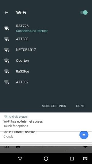

My Wifi apparently has no internet connection.
Lucas McDonald
Mar 10, 2016
I'm using my Nexus 6 with Android N and my wifi connects to my home wifi but it says that the wifi has no internet. Please Help.

After assuming the following...
> You tried rebooting your router.
- or -
> All you other WiFi devices are singing along just fine.
You can then go to YouTube for the following nonsense:
- Configure your router for 802.11b (as if!)
- Set your IP address to Static (again, not a true fix)
My son's 5x just got into this state and it took a while to figure it out. But apparently he had somehow switched his time to manual. I switched it back to automatic and voilà!
- Settings -> System\Date & time -> Automatic date & time -> Turn this on (Use network-provided time)
I can't explain why this was needed to allow the WiFi connection. All I know is that his time was about right but the date was 19 days old. I discovered this as I was syncing his backups in prep for a factory reset. Certs issue, maybe?
