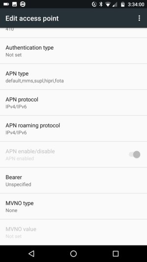

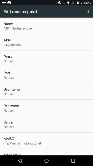

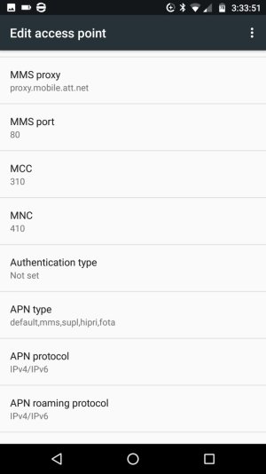

@312MotoGus
Could take a screen shot of the balance of the APN? This is not very helpful. If I click the photo, there is only the one screen shot but no details. I need the details.
Here we are:
Here we are:
Many thanks. I'm using that same group of settings & no LTE.
Enjoy the speed while it lasts!
