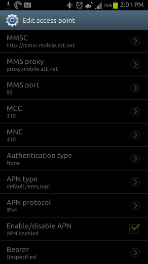

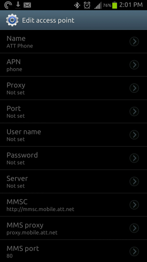

I swap my SIM between an iphone 5 and my Nexus 4 almost daily. I used this forum to change my APN settings and I have no problems. Do some searching. It should be easy to find. If you can't find it let me know and I'll screen shot my APN and post it here.
Could you provide the screenshots? I've tried all the ones and still get gray bars.
