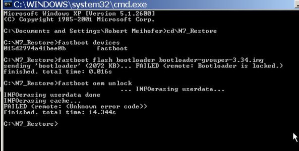

I am having a locked out problem with my Nexus 7 (bricked)
Can get into FASTBOOT MODE
with grouper 3.34 but LOCKED
flashboot flash bootloader bootloader-grouper-3.34.img
FAILED - remote: Bootloader is locked
fastboot oem unlock
FAILED - see screenshot above
N7 screen displays "Unlock bootloader?" dialog
Selecting YES and entering with power button
produces screen message:
unlocking now.......
for a few seconds, then replaced with
neither USP nor CRC partitions found
which repeats every few seconds and fills screen.
Any help or suggestions would be greatly appreciated.
Thanks in advance,
Bob Meihofer

Reinstall the adb/fastboot drivers.
If it's saying that it can't find partitions after running the unlock bootloader command, then that's pretty scary. If the bootloader is erased then the device is bricked, at least until we get a working version of nvflash for the nexus 7.
I hope you get this sorted mate.
