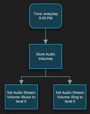

I use Automagic to do that. It is very easy to do with a flowchart in Automagic (no coding). It does not affect your alarm. (Your alarm will still sound loudly. But, if for some particular reason you want to mute the alarm as well, you can even do that!) Lots of options.
Here is the flowchart to "Mute the speaker/audio" everyday at 9 pm:
