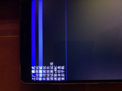

Thanks for your reply, I have created an account. I will give you some more details. I tried to follow a couple of Youtube vids to no avail. The issue is that with most of them it involves finding a Firmware from where I am from and all I can find is us, China etc the model of my device according to the settings is sm-n9500.
I watched a couple of vids and they basically state that I needed to get my phone in download mode and when I follow as is instructed either the screen does not appear or I get the following. IMG_3729.jpg
which is all in Japanese or i think it is. I have no idea what has been done. I have been to the Sammobile site and for my model of the device there is only firmware from Hongkong or china and I am from the UK.

Right I think I know the issue, I believe the phone is a fake Note 8 so you live and learn. from what I have looked on the sites to compare the real with the fakes I have purchased a fake so you live and learn.
