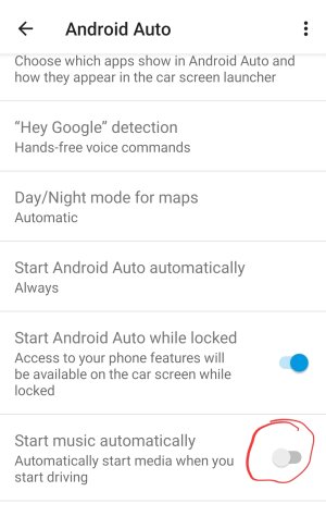

If you turn off "Start Music Automatically" in the AA Settings, that may fix the issue. I had the same issue with XM being turned off whenever AA Launched. That fixed it. I also had issues with Spotify and Pandora automatically launching if they were installed. So, I hid them in customize as I never use them.
That worked fine. However, I now have a different issue. None of the music titles from the CD are displaying. Another deep dive in the manual, I guess.
