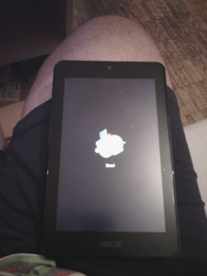

Device reboots with the little android animation "installing update"... then quickly proceeds to the android "laid down" with "Failed!".

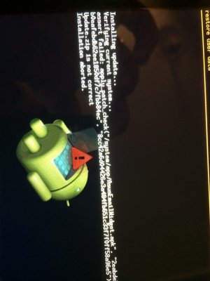

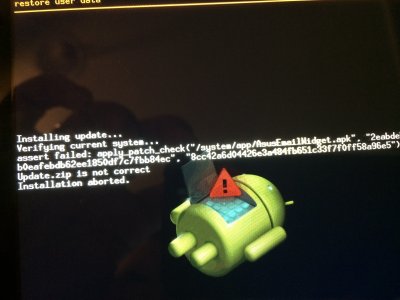

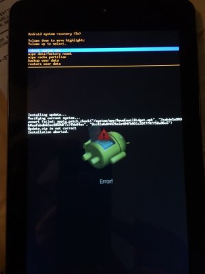

The following is what comes up if I press the power button after the failed attempt:
A close-up:

Welcome to Android Central! The screenshots indicate that the downloaded file that you were trying to use for the manual install was probably not the correct file for your specific device--is there any way to confirm that it was the right file?
This probably won't do anything, but try selecting "wipe cache partition" from the Recovery Menu, then "reboot system now," and when it's restarted, try the automatic update from Settings>About Tablet>System Update​ again.
First, I am surprised that there is no apply update from zip option in recovery, and I am also surprised that they told you to unzip the file. Android can read .zip files.

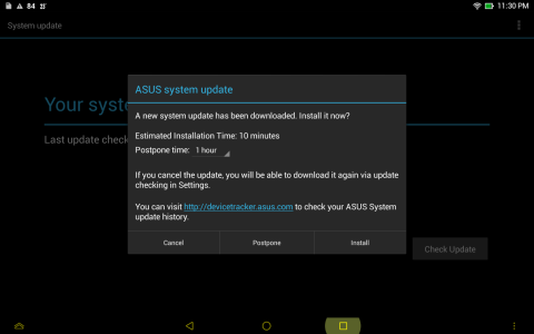

I have a problem with OTA update, I downloaded it from internet, as shown on picture, click on install and ERROR :-(
Can anyone post a link or send me a message with a link to where I can download the latest update from my PC, not from the memo pad.
