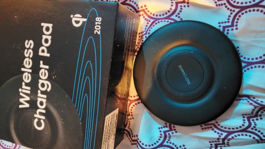

It's the charger, will show you it's charging but like 5 to 10 min it will stop charging the phone especially if use a case like Amarillo Tek , so what i did was use a different Samsung charger and all works with no issues.

This is the one i use with Amarillo Tek case and UAG Monarch and UAG Plym. And works with no issues at all. 20191126_152029.jpg
