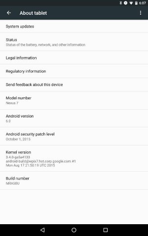

I got an OTA today. I am already on 6.0 . This was a bug fix I believe. It is only 2.2MB in size. Anyone else get this?
Maybe this fix is what's holding up the OTA for build LMY48T. At this point, Google hasn't offered any explanation why the OTA is being held up, so I'm past caring anymore. Whenever they release it, I'll install it and we'll be done.
Updates to MRA58U

Apparently that bug fix is the reason for why the OTA for 6.0 hasn't rolled out yet. There was a bug that screwed up video playback. This 2.2mb update fixes the issue for those who've already sideloaded the MM update.
"MRA58U is an update that fixes the video playback issue with the MRA58K build on the 2013 Nexus 7. Video would hang after a few seconds, with audio continuing to play on almost any app except Google apps. Netflix and Vudu were affected, among others.
Google appeared to stop the roll out of the 6.0 OTA to Nexus 7s after the issue was discovered/reported. I sideloaded the Marshmallow OTA on my N7 only to break the video playback. A friend's 2013 N7 has yet to get the Marshmallow OTA."
-From user jbrossard here on AC forums.
So apparently once they integrate this bug fix into the OTA it should start rolling out.
