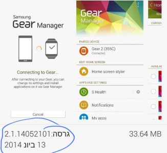

I've noticed that the 'gear manager' was updated 3 days ago. Are you guys on ##52101? Still hope it's just a software issue...

I just received a brand new Gear 2 Neo and it updated out of the box to 2.1.1402101. BAttery drains quickly with either Bluetooth or Wake-up gesture switched on. I'm using mine with Galaxy S3. Those who had the old Gear Manager seem to report much better battery life so I too suspect the update.

What version of Gear Manager are you using? Has it updated recently?
Mine is 2.1.14052101 updated on the 13th. (always hated the Friday's on the 13th..) For those of you who have the older version I suggest stay with it until you'll know better

That version has been out for a few weeks, so it's not new and was released well before Friday the 13th.
Strange.. It says that on my Samsung apps.. See pic attached
