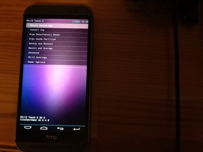

at part IV instead of doing highlight perm root I accidentally flashed a kernel and now seem to be stuck on Philz Touch 6 and can't really seem to do anything with my phone, it just has reboot system now, install zip, advanced etc
I don't really know what i've done, how to sort it, and go back to just the standard OS and start over again and do it properly :/

After reading through the process, it looks like you flashed a custom recovery. Did you happen to make a nandroid backup? If so, then you should be able to reboot into recovery and restore from your nandroid.

Philz Touch is a version of Clockworkmod (CWM) which is a CUSTOM RECOVERY.
I think you must have wiped the phone so now you'll either have to restore a stock firmware OR load a custom rom (my preferred choice)

Since Philz Touch 6 is actually a Recovery, then you should be at step In of your guide.

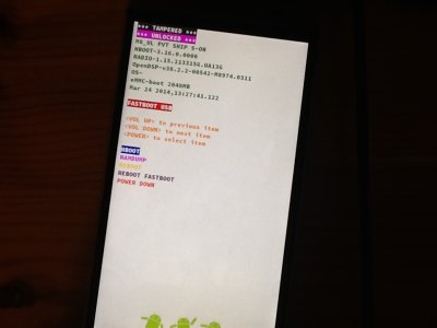

So I now can't seem to get out of this area apart from going into power options and booting it into bootloader where it looks like this:
So I tried, with the phone in bootloader as above, using the program to flash a recovery and perm root however I get an error saying that a device cannot be found in the cmd prompt that shows up
OK, Philz Touch 6 and TWRP are both recoveries. You are done with the recovery part. Question is which one is still on your phone, Philz or TWRP? If you power off your phone and then press Power and Volume Down buttons simultaneously it should boot into bootloader. Then use the volume buttons to highlight recovery then press power to select. The phone should go into recovery. In that screen it should say whether you have Philz or TWRP. They both do basically the same thing. What you need to do now is download a ROM and flash it from recovery. A good solid performing ROM is CleanROM 1.0
