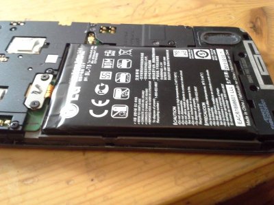

Opened the back today after the other side of it simply popped out. I reckon I found the problem as well...
