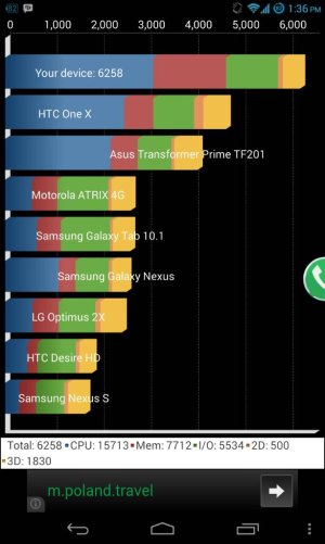

Franco's is not far off...it's all down to optimization.
