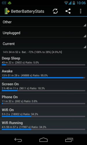

Thanks for your answer, I've disabled everything under Location Access. I've attached a screenshot before I put the phone aside for the night, the battery is fully charged and DSBS is running on the maximum setting...

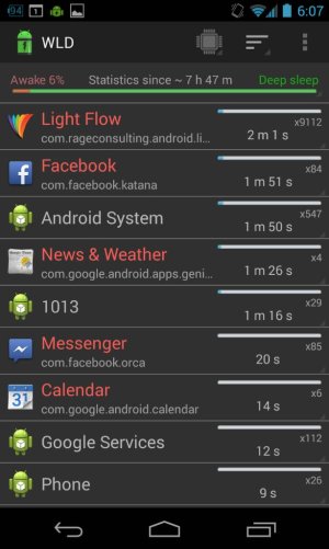

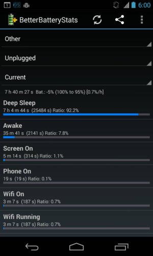

as you can see my N4 did deep sleep for the greater part of the night, dropping 5%. Using Wakelock Detector I got the following results
I really have no way of knowing if the results I'm getting are because I disabled Location Services (only the WiFi bit was checked) or if it's just another fluctuation in deep sleep behavior. I'll try it for another night and see what happens....

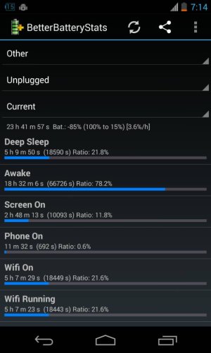

Right, so here are the before and after screenshots of night 2:
As you can see the erratic sleeping pattern has returned :(
Suggestions anyone?

So for example I left my phone off for 2 - 3 minutes and I noticed that afterward, I'd get 30% of the time NOT in deep sleep and idling at 384 mhz.
Turning off sync I got about 10-15% awake time. Better.
Location reporting is off, but I don't see how the phone doesnt idle. The thing that no one is really addressing in the OP's post # 7 (http://forums.androidcentral.com/go...wakelocks-android-4-3-update.html#post3001949) is that the phone wakelocks for 35 minutes, and 7.8% is much better than I saw, but if you add up the individual wakelocks in Wakelock Detector, it does NOT add up to 35 minutes. I've had trouble on my side figuring out what keeps my phone awake because WLD only shows part of the picture.

Thank you! That is exactly the problem I'm trying to figure out, my phone isn't deep sleeping but there are no apparent wakelocks...
However, after disabling Location Services I did get 2 nights of continuous deep slumber, of course I'd have no idea if it's just another change in behavior...
If anybody has a permanent solution, it would be greatly appreciated!
